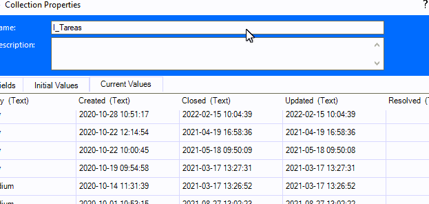

  • What format does you date-field in 'Collection In' have?

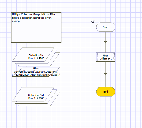

  • Exactly what action do you use for filtering?
  • Can you include a screenshot of your Inputs for the filtering action?
I have changed the Filter Text multiple times.
  • "ToDate([Created]) > "&"'" &[I_UltimaRevisionFiltro]&"' AND ToDate([Created]) < "&"'" &[L_Today]&"'"
  • "Convert([Created],'System.DateTime') > "&"'" &[I_UltimaRevisionFiltro]&"' AND Convert([Created],'System.DateTime') < "&"'" &[L_Today]&"'"
  • ToDate("[Created]") > "'" &[L_UltimaRevisionFormateado]& "AND "ToDate("[Created]") < "'" &[L_TodayFormateado]&

Your expression for filtering against a given date would look something like this:
35359.pngThe fiddling with the double and single quotes is as the date (text) would need to be between single quotes. Your finals expression would end up like:
With some experimenting you can replace the fixed date ('2023-01-02' in my example) with a data item. I'd suggest you start by running the filter with a simple filtering statement first, as above with only one date. Once you get the hang of it and it works well, then you can add the other dates with AND to complete the equation.
