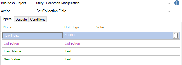

On object 'Utility - Collection Manipulation' you'll find action 'Utility - Collection Manipulation':
35339.png...that might do what you need.
Alternatively, if you happen to be looping through the collections anyway, you could change a row value by a calculation stage.

Hi Paul,
I thought about using that objects' actions but they happen to work the same way as my code. They take those inputs, included the collections, load them into a code stage and make the necessary changes. That is what I'm currently doing on my code stage and what's taking so much time (1-1.5 seconds more for each row when I have collections this big).
Also, I'm not looping through the collection, I don't need it because I have the index of the exact row I need to modify in each iteration.
