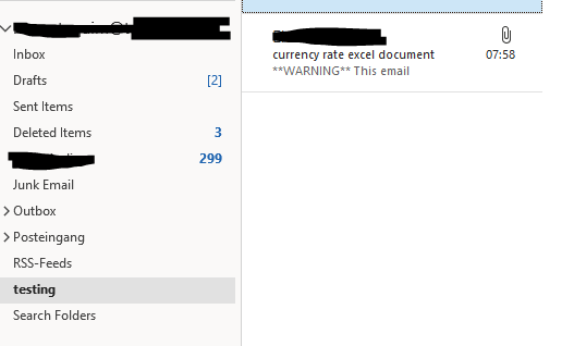

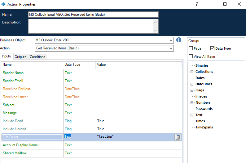

I am working on a project where some specific emails are stored in a folder called "testing" (screenshot 1). I need to read only these emails. For this reason I used MS outlook email VBO "get received email (basic)" with subfolder name "testing" (screenshot 2). Unfortunately, it shows the result 0 ( item count: 0, item: empty). How can I solve this problem?

Have you downloaded the latest release of the Outlook VBO from the Digital Exchange? If not, start with that. Once you have it, you'll want to look at the action Get Items in Folder. Check the help or user guide for details about how to reference folders using the \\ notation.

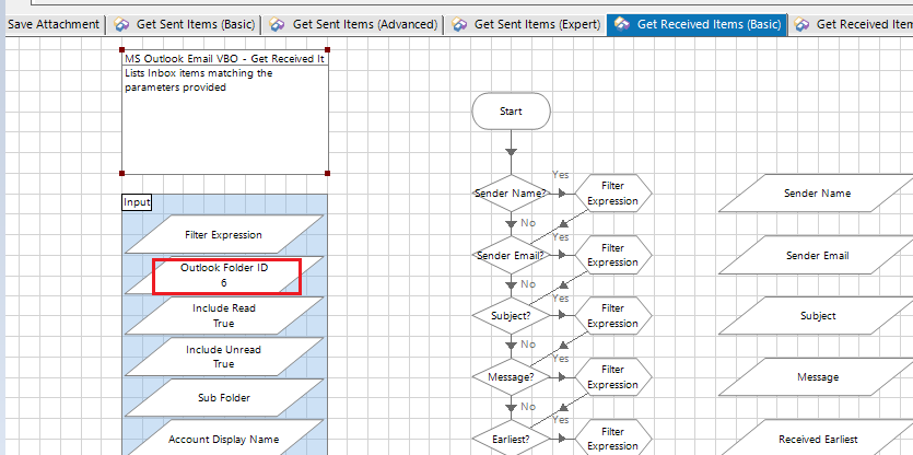

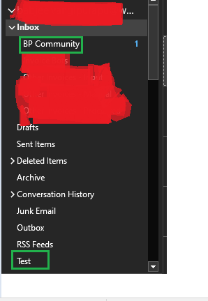

Reading from sub folder mean it should a child folder for Inbox as shown in below screenshot. Here BP Community is a subfolder of Inbox from which we can read emails from, whereas Test is not a subfolder
We can read an email from the other folder outside of Inbox by knowing the MAPI Folder ID that is mapped to it by outlook.  By default the Folder ID for Inbox is 6 (as shown in screenshot) similarly if you can get the folder ID that is mapped to the folder outside the Inbox in your case for testing.
Hope this helps for you

Thanks @ewilson for informing the new update of the MS Outlook VBO. It worked.

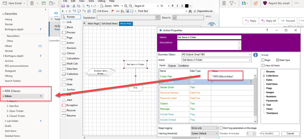

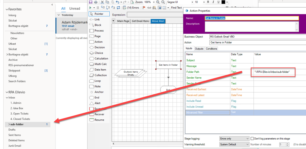

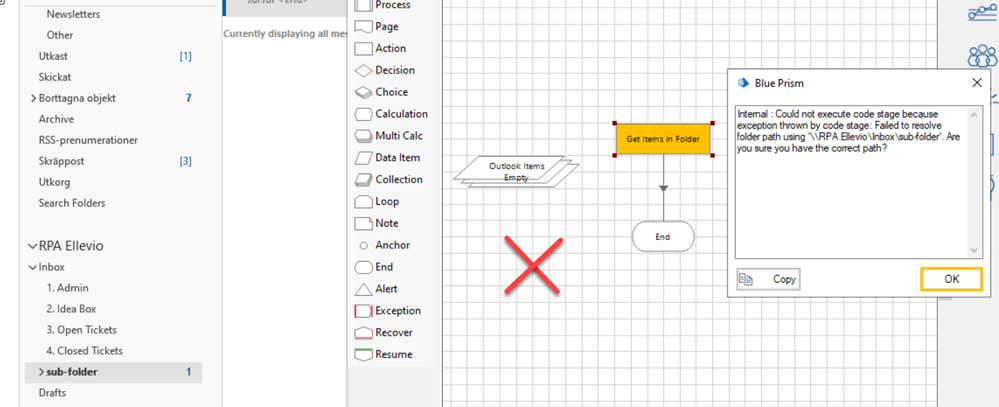

Get Items in Folder does not seem to work for a sub folder within a "Shared Mailbox" (I've tested Get Received Items as well, it gives same result). Is there a solution to this problem?
Fetching from Inbox which works:
However, trying to fetch the item in the sub folder:
ewilson
Hi Adam,
First, are you using the latest release of the VBO available from the DX? Second, can you try changing your folder name to something like test and try it again? Occasionally, special characters or even white space at the end of the folder name can cause the search to fail.
Eric

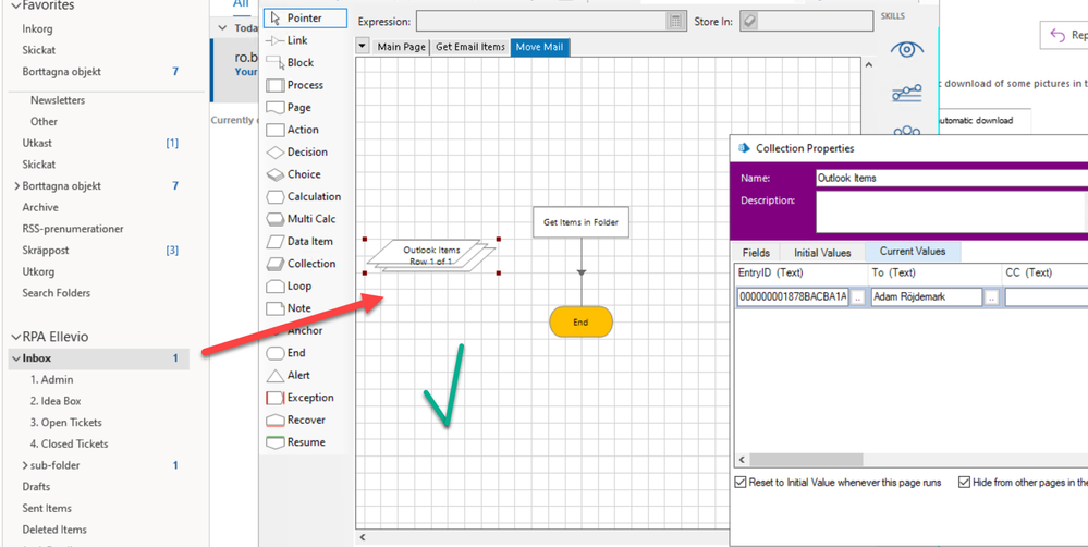

AdamRöjdemark
Yes, I have the latest version. For some reason it worked today after I changed the name of the sub folder. It even worked after I changed back to "sub-folder". Very strange...
Anyways, thanks for a quick response!
ewilson
Adam,
One thing that might have played into this is that Shared Mailboxes aren't always sync'd to the local PST file in real time. There's a setting in Outlook that controls how they are managed. The Outlook VBO uses the local Outlook API to interrogate data in the PST, so if the folder hasn't sync'd from Exchange to the PST that could cause the search to fail. 🤷‍♂️
