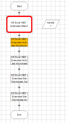

I'm testing with the MS Excel VBO - extended to Attach to the Excel instance that's already up and running.
It seems the Attach action of the MS Excel VBO is not working for the Excel invoked by the 3rd-party application or manually.
Did I miss something in this test? or
Can anyone suggest the way to attach the existing instance of EXCEL that's invoked by the 3rd-party application?
1. the excel file is invoked firstly and one instance of EXCEL.exe comes up and running.
2. Try to attach the EXCEL instance using the Excel VBO as below:
3. It's observed that the Attach action invokes another instance of EXCEL.exe separately as shown below and thereby fail to attach to the first instance.
Best regards
HongJoo Choi

Hello HongJoo,
Yes as you guessed the error is down to the process being unable to attach to the open excel as there are 2 instance that you can see in your task manager. There is a way round this.
1. Are you able to save the excel spreadsheet and then open it again using blueprism? Are you able to save it and then open it again? The steps would look like
Close all instances > Create Instance > Open Workbook (using the full filepath as name) > Get worksheet as collection (preferred choice)
Hope this helps.
Sadly Attach and Attach to workbook both create new instances so these aren't viable is the excel is already open.
