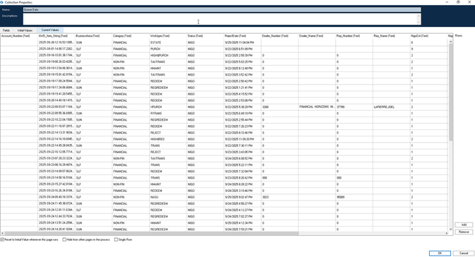

Example:
I was actually able to get the same error thrown in Design Studio. I ran it a few times to see a pattern and I could see that it kept happening at row 16 and at the same cell. This cell came right after a date, however this date is coming in as a text format (collection example above). So it did write the date but then the next cell it failed. The next cell however was simply text again but in this case the field was blank.
The expectation here was that it would just write "" to that cell. That's what it did in the above rows when that field was blank.
What I did next was simply put a 0 in that collection field and ran it again. Again it failed at row 16 but this time at a different cell. It was was the last column of the row.
This row is for "comments" which are comments the DW has extracted from a work item in an application. These comments are free form and can contain any character. I noticed there were "=" and what looked like "*". I removed these characters and it the next time it worked.
I tried to reverse this to see if it would fail again. I first removed the 0 I placed in that empty field and ran the process again and it worked. I then tried to add some "=" and other characters to test and it worked again...this confused me.

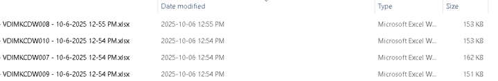

Also, I want to add that I tried running this process again in production and for the first time it worked. All 4 DW's completed the process and successfully generated their Excel report.
You can see reports saved around the same time.
Now why it worked this time vs other times? I am not sure.
