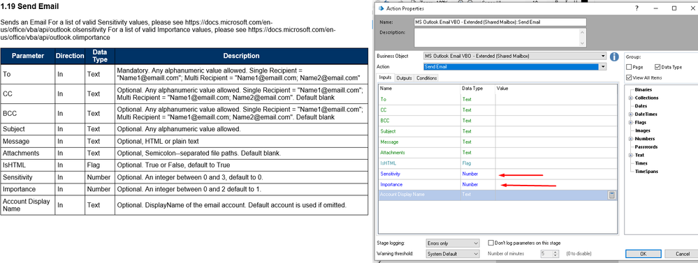

HI,
I'm trying to send an email with Some Classification using SMTP. BUt BOt not able to send with SMTP so I'm trying send  using SMTp, How can I use the classification in MS out look?
When I try to send an email it is triggering some pop up to select the classification.

 And Added below code in the send action in SMTP VBO, But it is still not working
mail.ItemProperties.Add([OrgName],OlUserPropertyType.olText) = [Classification]

Thanks for the quick reply. I have not run into this issue but did some research and found this:
The standard MS Outlook VBO does not support the classification of emails. However, it is possible to customize the outlook VBO to allow the classification of emails.
To customise the VBO, additional code will need to be added to the MS Outlook VBO's 'Send Email' action:
The different code options for the existing email classifications and code options are as follows:
Sensitivity Code
Normal OlSensitivity.olNormal
Personal OlSensitivity.olPersonal
Private OlSensitivity.olPrivate
Confidential OlSensitivity.olConfidential
Hopefully this helps.

HI Jack,
Thanks for your response, I tried that code its not working , May be It's because I'm using Titus classification.
There is some thing I misstated above, I added below code in MS Out look VBO

I found that in the new version of BP 6.8 (soon to be released) this function is added to the product.
Stay tuned for the release in the next weeks.

Hi Lopez,
Thanks for that information, But looks like, It only works for  default outlook classification. What about 3rd party add on in Outlook such as Titus?
