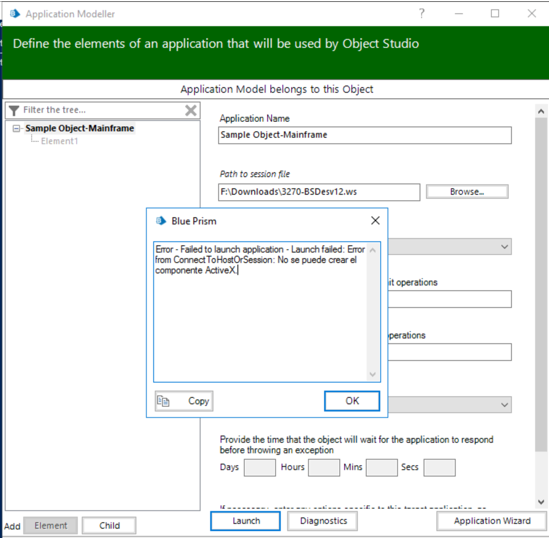

I am working on Mainframe automation using BluePrism for which I am establishing the connectivity by configuring below details in Application Modeler (Object Studio).
Any suggestion / solution to overcome this issue?
Arun Kumar Palanisamy
- Indicate what type of application you are using: Mainframe Application - IBM Personal Communicator (COM API).
- Path to session file: I have provided the folder path where the session file (*.ws) is present.
- Session Identifier: A
- Polling interval (in milliseconds) during wait operations: 250
- Timeout interval (in seconds) during wait operations: 30
- Select the Application Manager mode: Embedded (default)
Note: I am using 32-bit windows platform.
After Save and Launch, it throws below error.Error - Failed to launch application - Launch failed: Error from ConnectToHostOrSession: Unable to create ActiveX component.

My machine is 32-bit and I am able to launch the TSO Emulator application manually with no issues. The above issue I am facing is when establishing the connectivity from BluePrism.
Note: The IBM Personal Communications package is installed in different server and I am trying to connect and launch the application from different VDI where BluePrism is available. Will this cause this error?

My experience with this is the need to have the emulator installed where you are running your process. In my, and probably your case that means I need it on my development VDI in order to be able to create, test and maintain my object, and for running the process in production, the emulator needs to be installed even there. This means two installations, and two licenses. ...and probably paying twice...

Even if the IBM Personal Communications package is installed on another server, the API module must be installed and configured correctly on the local machine. Why don't you first check that the API is working fine?

Blue Prism supports PCOMM via COM API or HLLAPI
The message "Unable to create ActiveX component." indicates that you've chosen IBM PCOMM (COM API) option.
It also shows that some configuration for COM Objects such as ActiveX components has not been configured properly.
Probably some vendors message book will help you.
Refer following, for examples.
https://docs.microsoft.com/en-us/office/troubleshoot/access/activex-component-cannot-create-object
https://www.ibm.com/support/pages/incompatibility-between-ibm-personal-communications-automation-objects-and-64-bit-microsoft-office-programs
