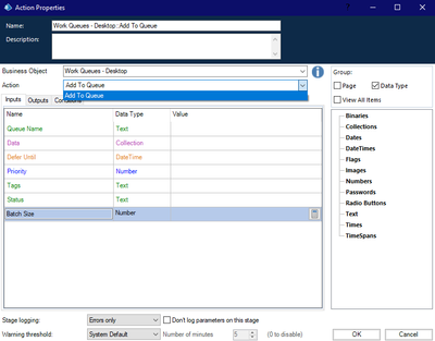

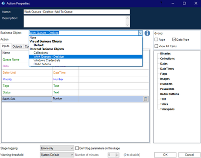

I am currently facing an issue with the Work Queues functionality in Blue Prism version 7.3. In my environment, I am unable to locate the standard "Internal - Work Queues" Business Object that typically contains a set of actions for managing work queue items, including the "Get Next Item" action.
Instead, I only have access to a Business Object named "Work Queues - Desktop," which seems to have a limited set of actions, with only "Add to Queue" being available. This is preventing me from properly retrieving and processing items from the work queues in my processes.
I have attached screenshots of my Blue Prism environment showing the available Business Objects and the actions within the "Work Queues - Desktop" Business Object for your reference. Version of BP 7.3

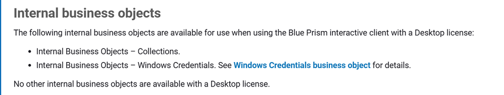

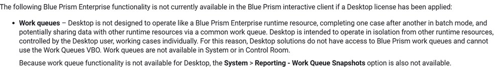

What you are using is called Blue Prism Desktop which is a different environment that Blue Prism Enterprise even though both are accessible from the same Blue Prism Studio application as part of the latest offering that Blue Prism has now since v7.
Basically, what it means is you currently are working with a Blue Prism Desktop License which is focused on desktop-based automations where users are directly contributing to the running of a process, with the expectation that the automation runs consistently and successfully rather than an unattended RPA use case where workloads are processed in bulk and digital workers loop continuously, working case after case, operating in a clean, consistent, and unobserved environment.
In Blue Prism Desktop, we have a lot of differences from the standard Blue Prism Enterprise functionality which has been mentioned in details here. This clearly states the following point which is why you are unable to see the Work Queues business object:
Technically, one can have both Desktop and Enterprise license and simply switch between the two if you System Administrator has assigned you both of these licenses. To check what license you exactly have, navigate to System > System - License. The Active License field at the top of the screen displays which license type is applied.
