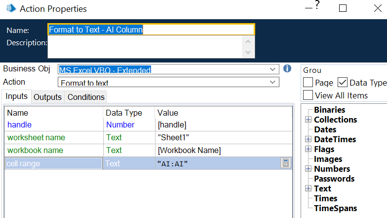

1) Open MS Excel Extended VBO - Add an Action - Format to Text
Add Handle, Workbook Name, SheetName, Cell Range as input and add below code to code stage as shown in the image
Note : Cell Range for your case should be - "A:E" or "A:F" depending on how many more columns you have in the excel sheet (You can see snippets below I have passed "AI:AI" as I needed one column to be formatted as text - if not sure of range then simply pass "A:Z" for the entire sheet  and save workbook post formatting it as per defined range.
Dim ws As Object = GetWorksheet(handle, workbookname, worksheetname)
ws.Range(CellRange).NumberFormat = "@"
Once you have formatted the Columns - Continue with your OLEDB Operations and Data will be exactly how it is on the Excel sheet, let me know if you find any difficulties implementing this.
