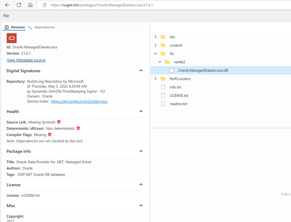

The error is about the Oracle.ManagedDataAccess.dll  file, am I supposed to locate it in a specific location? it's installed already
aseel odeh
Hi Aseel,
This DLL must be present in your oracle ODAP installation folder. You can try to copy that and paste it in your Blue Prism installation folder. If you are unable to find the DLL, then you can download the same from the Oracle.ManagedDataAccess Nuget Feed
