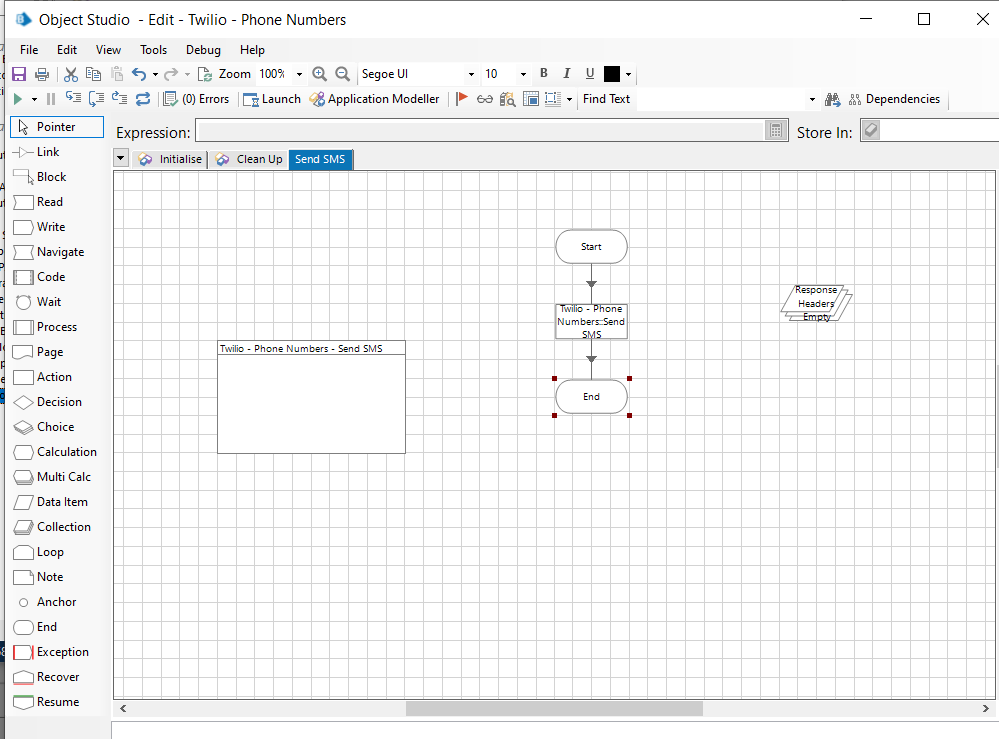

Hi Team,

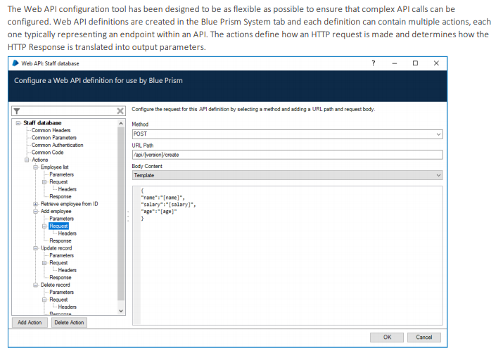

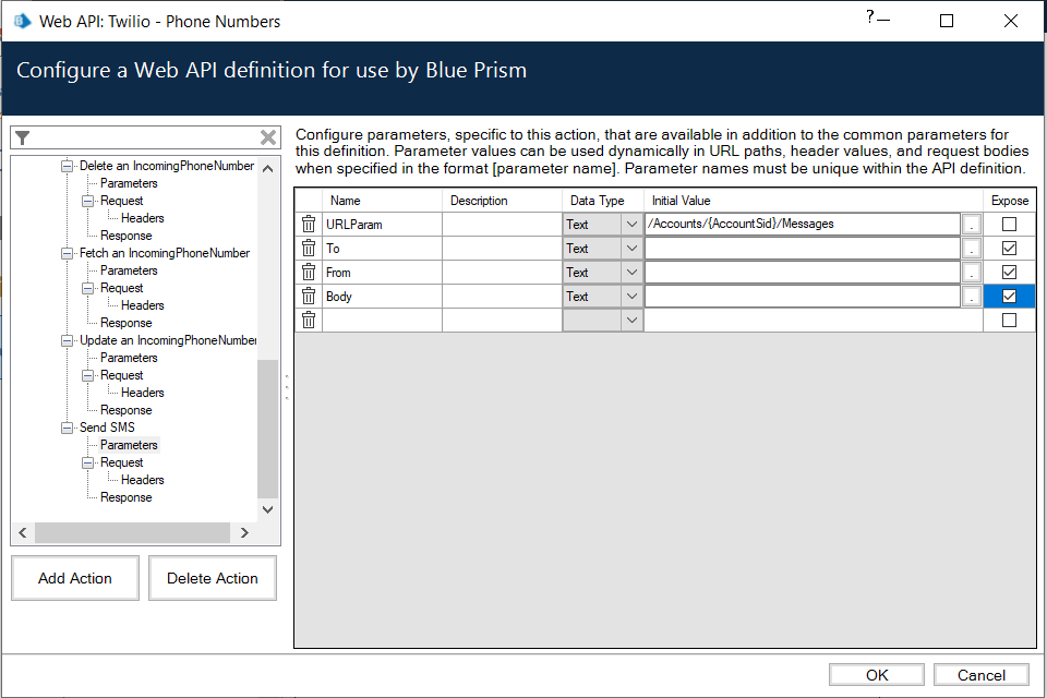

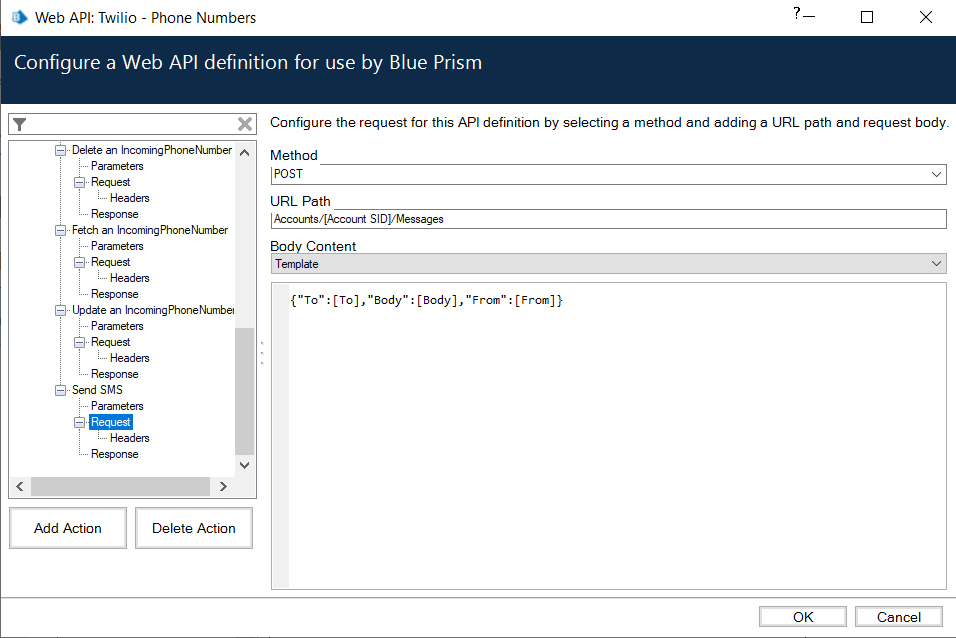

I am trying to call Twilio API to send SMS which post method. I want to send body parameters like To, From, and SMS text. Not sure how to send the body. I'm referring to this document for web API calls. https://bpdocs.blueprism.com/bp-6-10/en-us/z-pdf/web-api/v6.10%20Web%20APIs%20-%20User%20Guide.pdf
In parameter
In Process-
Its Giving error status code 400 as "21604- A 'To' phone number is required"

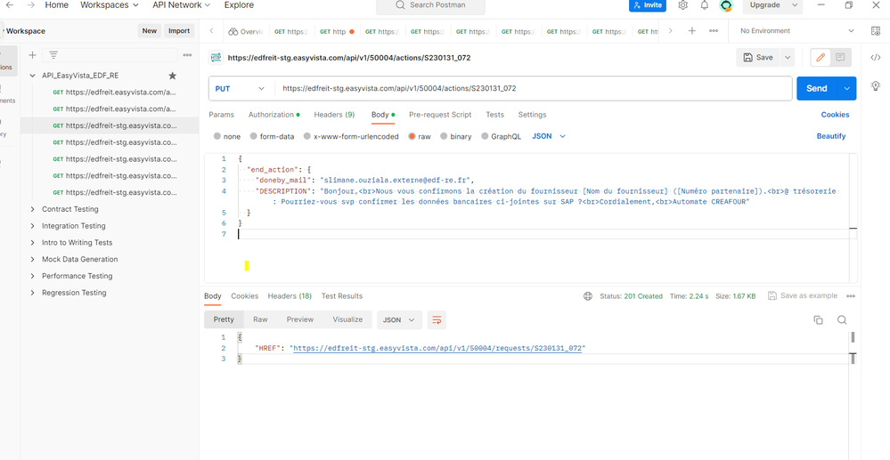

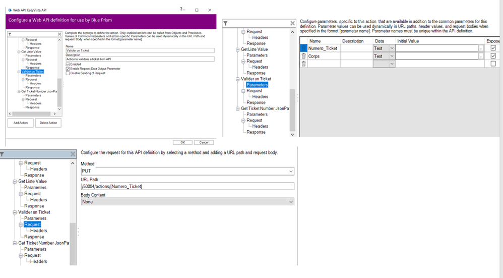

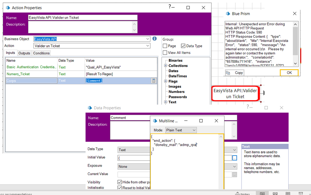

I try to update a ticket on EasyVista via an API call (PUT method) but it does not work, it works very well via PostMan but with the action which I created in my web service I have this error :
Internal : Unexpected error Error during Web API HTTP Request
HTTP Status Code: 590
HTTP Response Content: {
"type": "about:blank",
"title": "Internal Easyvista Error",
"status": 590,
"message": "An internal error occurred.\r\n Please try again later or contact the system administrator.",
"correlationId": "657832bd35275",
"instance": "/api/v1/50004/actions/S230131_072"
You Can find more explication with picture

I use the same doumetation for this action, but for Validate ticket I have to use .../actions/{rfc_number}
the linke is here : https://wiki.easyvista.com/xwiki/bin/view/Documentation/Integration/WebService%20REST/REST%20API%20-%20Finish%20an%20action%20attached%20to%20an%20incident-request/
Here you can find a copy of my Postman request
Thank you for your help.
