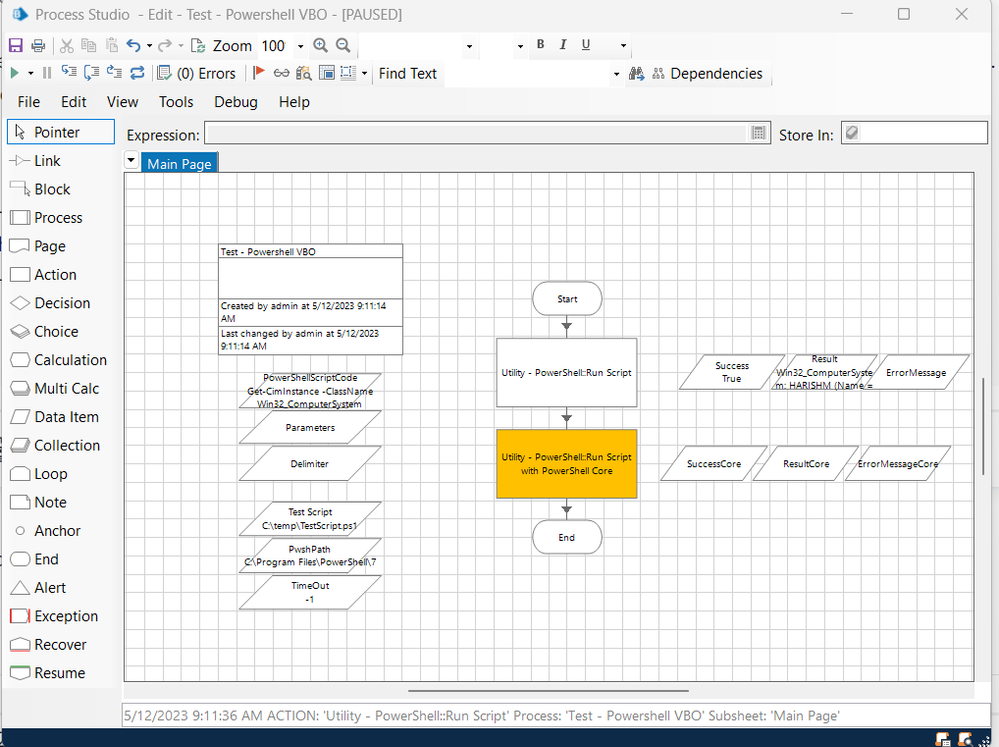

Once you download the VBO  it has test process VBO as well - I have tested if you  see the below screenshot I got output when i use Run script Action.
What is the command you are using ?
