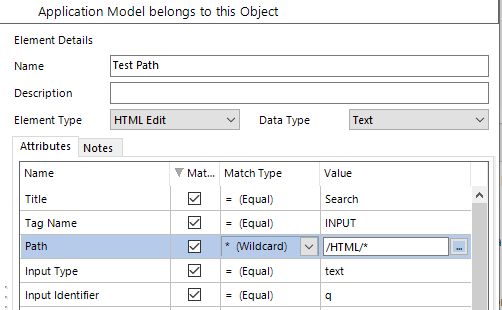

I am able to match like this:
Path (Match Type: Wildcard): /HTML/BODY(1)/*/INPUT(1)
Parent URL (Match Type: Wildcard): https://www.facebook.com/*
Match Index: 1
In the above scenario, the full HTML Path is something like this, so you can see that I replaced quite a bit of the path with an asterisk: /HTML/BODY(1)/DIV(1)/DIV(4)/DIV(1)/DIV(1)/DIV(1)/DIV(1)/DIV(2)/DIV(2)/FORM(1)/DIV(1)/INPUT(1)
And, as insane as it may seem, this works too:
Path (Match Type: Wildcard): /HTML/*
Match Index: 100
When I highlight for the above, it doesn't highlight the specific element I want, but the point is that it does highlight an element. ? and # also seem to be supported as wildcards in the Path now.

@Dave Morris - This post is bit old but I am facing one challenge hence reaching out to you for some inputs. We are spying one element which has one of the html tag index changing every time in path, hence trying to make it generic with wild card. It was giving some issues and hence I thought to first give wildcard a try on simple google textbox.  ​
I observed that when i select path with wildcard option, highlight element is very slow as compared to not selecting path at all. When i use path with equals option it works at good speed.
So I want to check with you if selecting wild card makes BP identification very slow?
