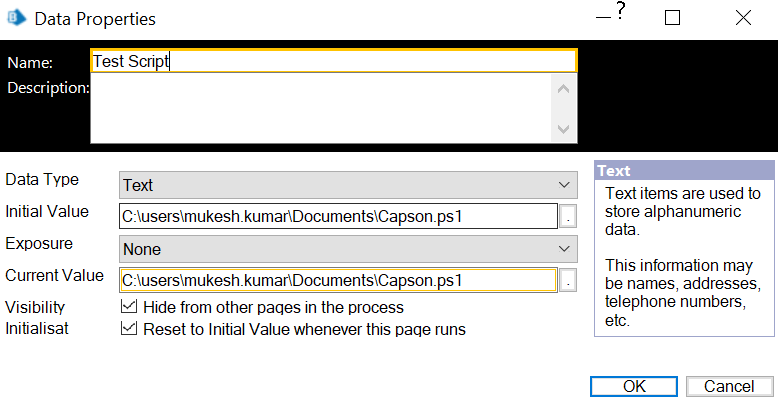

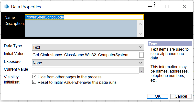

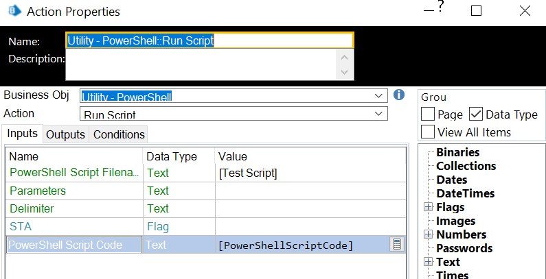

sai bhargava raja - I cannot run AD Module as its not available in my machine and if you have it you can customise your script to fetch data from list of email ids in CSV and write back the results to a Text/CSV file as well - Just for testing refer below screenshots for one of other script file I am using -
Example:

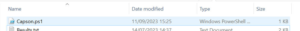

I would run my powershell scripts by giving the path of my script file with extension as .ps1 (write the script in notepad and save it with extension as .ps1) - powershell script that I have with me as sample script below is for toggling the caps lock on if its off) -
Script:
if ([console]::CapsLock -ne 'True')
    $wsh = New-Object -ComObject WScript.Shell;
    $wsh.SendKeys('{CAPSLOCK}')
Params for Run Script :
[PowerShellScriptCode] : Get-CimInstance -ClassName Win32_ComputerSystem
[Test Script] : Path of your .ps1 file

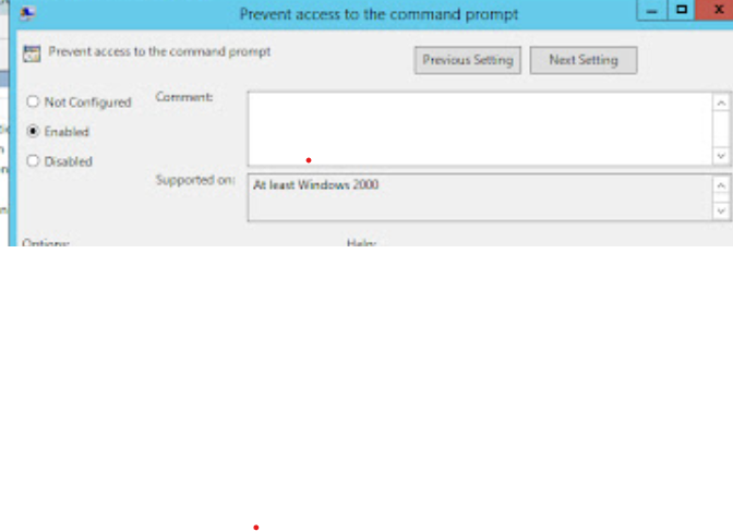

Hello, ask them to check if the security option "Prevent access to command prompt" is enabled.
Steps : https://youtu.be/pe6u_XacNbU
