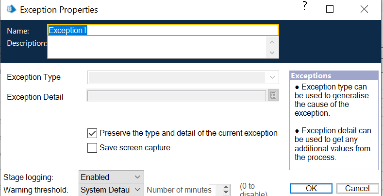

Hello All,
I was intrigued by one of the recent posts "https://community.blueprism.com/discussion/which-option-would-be-correct#bm9242b68c-377f-42fe-82da-0187938af29e".
Among the skirmishing, I went ahead to test the design & found alarming results (please see attached video)
The exception details are re-thrown (a.k.a preserved) even after Resume Stage.
Process validation is smart enough to realize that there is an error in the design and clearly calls it out, however the process runs just fine.
Is this a bug ? (Old timers working since v4 or 5 would say so)
Is this the expected behavior ?  (Newer developers have no reference point)
Let's find out what the experts have to say 😛

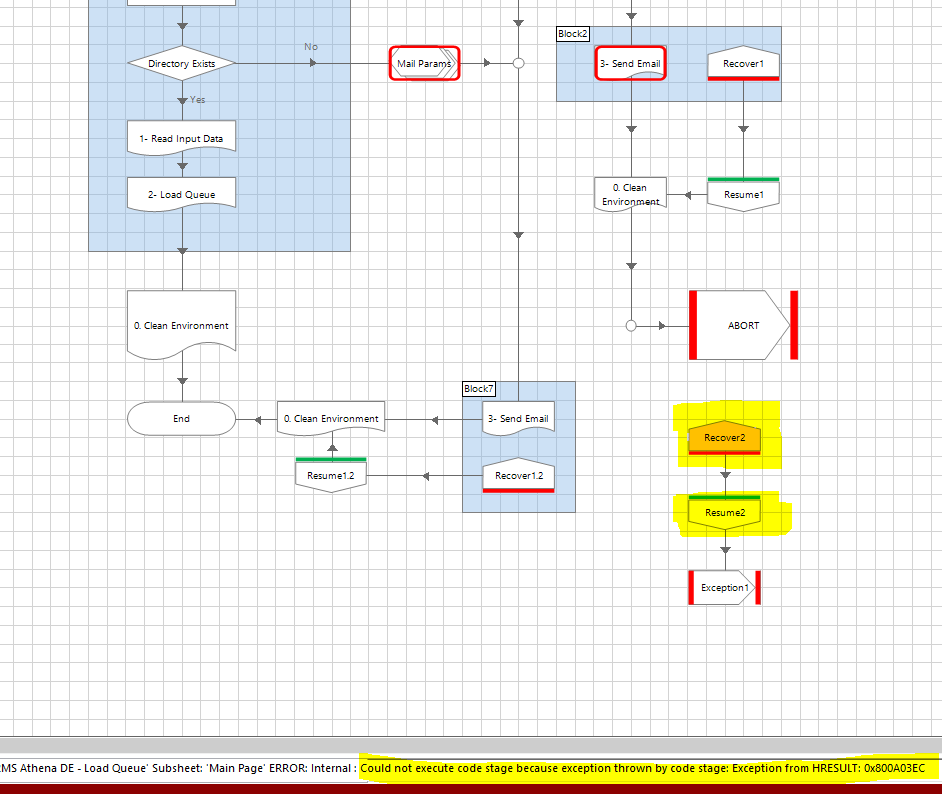

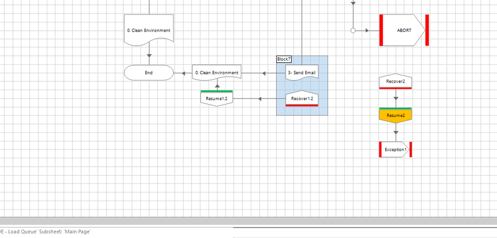

Hi @Babjee Vangipurapu : I did test this in Blue Prism 6.10.1 and it still throws same preserved exception (similar to BP 7.1.1 version) which should have been cleared by resume stage, See below, I hope it will help you understand the issue I am raising :
Exception Error at bottom bar before Resume and Re-Throw with Preserved checkbox Checked:
Exception Error at bottom bar after Resume and Re-Throw with Preserved checkbox Checked: Re throws the error similarly as @SahilRaina mentioned in above main query.

The exception detail is not correct but it is going to an infinite loop that is correct. Because you can not keep a preserve check after a resume page which gives you an error before executing itself in the Errors Tab. So in the resume stage, the Exception is getting neutralized and again it's throwing an exception eventually it will go to the recovery stage.
So the exception detail is not correct, but I think an infinite loop is expected.

@_Amlansahoo - Yeah that's what we are raising to get it checked by @ewilson - The exception details/message after the resume stage - it should have cleared the previous exception details after resume and rethrow should have popped up a new error message which the process validation is showing in the error tab, right now the exception details which is re-throwed is the previous exception message which is not right.
