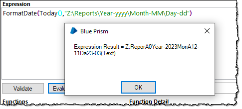

As an aside; most people don't realize that you can put almost anything in the string for a "Format" parameter in the FormatDate() function. Even formatting characters can be used in the string to represent their literal values as long as they are enclosed in double quotes.
For eg., the following string would be unusable to come out with a folder structure from a single FormatDate() function:

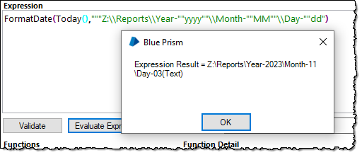

But using double quotes and escaping back-slashes with another back-slash makes it work:
