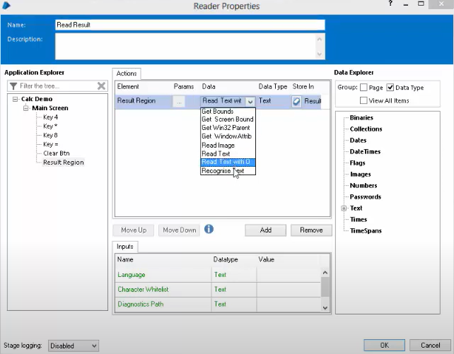

READ STAGE with different possibilities
How can I see more data type options in my read stage?

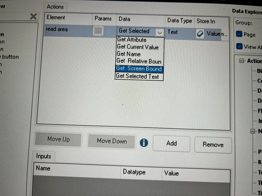

This is what I should see
This is what I see
Many thanks!

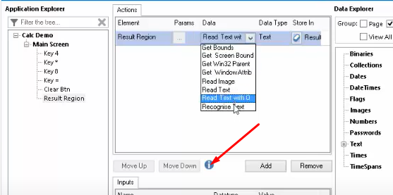

If you click on the Information button you'll see a list of all the operations available for all the element types.

Hi Sahar salehi,
In app modeler change the element type  to most relevant  element you are trying and check read stage.  I would try  changing  element type until I find the required action in read stage
2) if the action you are looking  is not present  then try to re  spy  some time playing around the element you will find  multiple options
