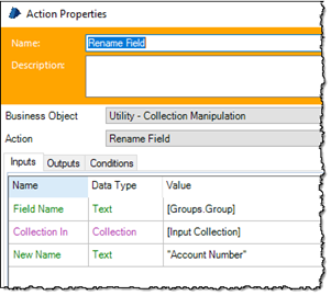

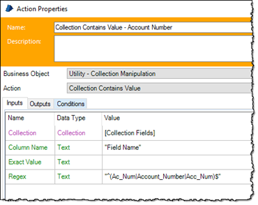

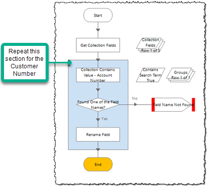

You could use stages similiar to the following:
  1. Getting a listing of the fields ([Collection Fields]).
  1. Using a regex pattern (that you could store in a BP Env Var to change on the fly) in the "Collection Contains Value" action in BP's "Utility - Collection Manipulation" VBO to see if the listing of fields finds any occurrence of the incorrect field names and if so, has that incorrect occurrence placed into the "Groups" collection .
	"^(Ac_Num|Account_Number|Acc_Num)$"
  1. Check to see if the "Collection Contains Value" action found one of those incorrect occurrences. If not, throw an exception.
  1. If an incorrect occurrence was found, use the [Groups.Group] value to rename the field to "Account Number".
  1. Repeat the blue section above for the Customer Number.
This assumes that you never get a field called "Customer Number" but if you did sometimes you can use the "Collection Contains Value" action with the "Exact Value" parameter to make a decision around all the above blue section stages.
