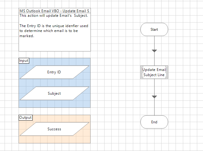

I need to rename an email's subject, the process will pass in the emails EntryID and new subject, then the object should rename the subject of an email and pass out a success or error message.

Hi @SakshiShivhare,
You can try below code to rename Email's Subject -
  •  Input Parameter - 1. Entry ID (Text) 2. Subject (Text)
  • Output Parameter - 1. Success (Flag)
Code Stage  -
  3.  Code -
​Dim app = CreateObject("Outlook.Application")
Dim _nameSpace As Microsoft.Office.Interop.Outlook.NameSpace = app.GetNameSpace("MAPI")
Dim item = _nameSpace.GetItemFromID(Entry_ID)
'Below line of code will update the subject line'
item.Subject = Subject
'Below Code will save the updated subject'
item.Save
'Below code will verify the updated subject'
If item.Subject = Subject
Success = True
Else
Success = False
End If

It is working. Thank you so much ​for the solution.​
