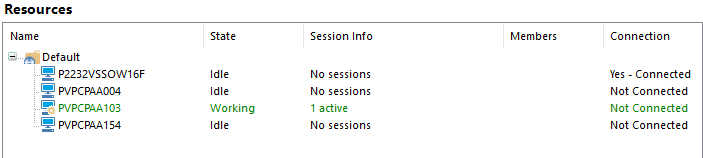

I have an Application Server running with 3 Resources​ which have been running perfectly for months, but in the past few days all 3 resources have gone from the connection status "Yes - Connected" to "Not Connected". I don't think I have changed anything which could have caused this. All resources can be seen as 'Idle' and we can start processes from those resources as well, just not from the Application Server, which caused the Schedule to break as well.

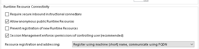

I have seen this in few of our environments too. the workaround i did was to change the runtime resource connectivity resource registry and communication setting to use "register using machine short name and communicate using FQDN. if your application server is located in a different address pool reverse lookup may not work with shortnames so using fqdn will help.

Hi Felix,
