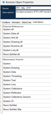

i already built re-usable object to work with SFTP , i can share the entire object, you have to paste that DLL in Blueprism automate folder
Below code will list files from SFTP to collection, you have to specify username , password , host and port number
note: below xml code is an action page from object. you can copy this paste directly in object, it will create new page with name called List Files.
here is the code option page, once you paste that DLL in blueprism automate folder, add below name spaces
all these actions you can do
