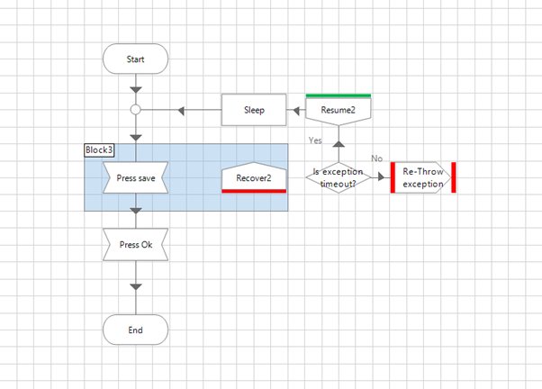

Hi Lorenzo
I would suggest in the case when you get an error when trying to save the file with large data then set exception handling to control the wait. Catch the exception and check what the exception detail is and if the error is what you expect when the file has large data and the save has timed out then use a wait stage or sleep action and loop back to clicking save after the wait period ends. If the exception is different from the time out error then you can handle that in the normal way.

Hi Lorenzo
