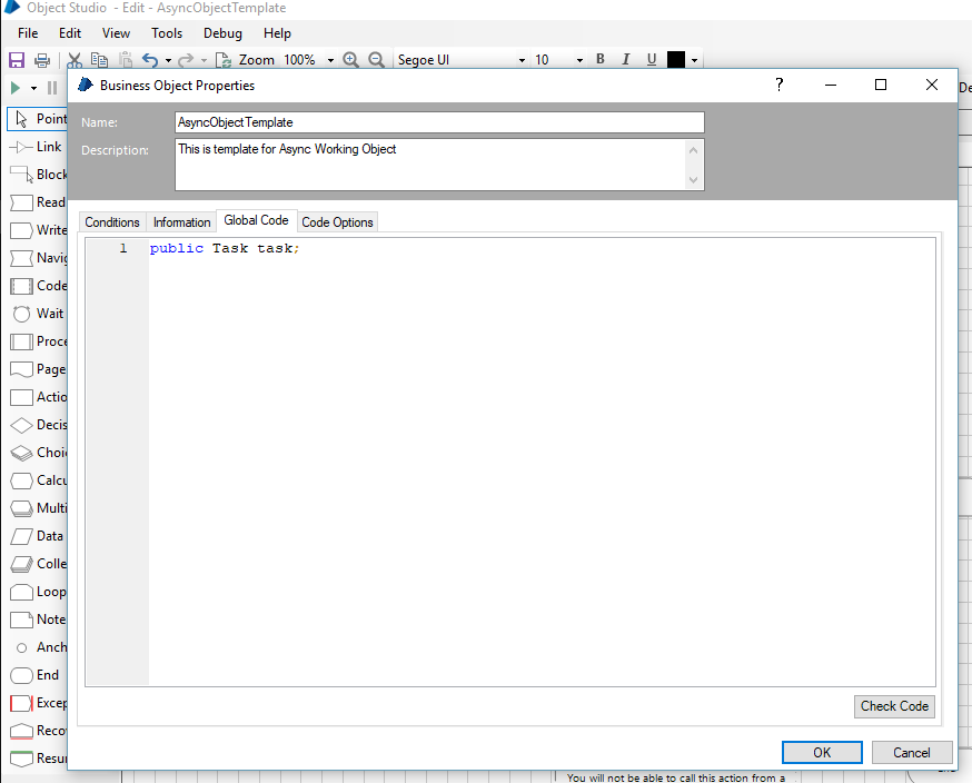

AliaksandrSauch
Hi, Niklas.
You can write the code that can track your popup and press the "ok" button with C# or VB.NET and run it in separate Thread in object.
Then you can call this action from your process and it will work in separate thread.
Important note: don't forget design it in such way that you cat stop this thread (for example call another action that kills this thread).
