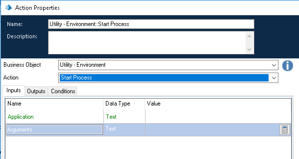

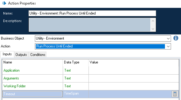

Python script is getting executed manually and the same is not working when invoked in BluePrism using below actions as tried both of them. It was also observed while troubleshooting that, there were 2 instances of Python installed in the VM by mistake with 32-bit and 64-bit. Is this the root cause which is creating this problem or something else needs to be done? Please suggest.

@esaugos,
When you try to execute the Python script are you providing the fully qualified path to the specific version Python executable and supplying the fully qualified path to the specific Python script as the argument?
