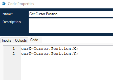

If you have already reverted then it's fine. But since the hover works fine, getting the mouse coordinates is straightforward which you can then pass to the Mouse click action using Utility - General.
Below code stage gets the coordinate.
