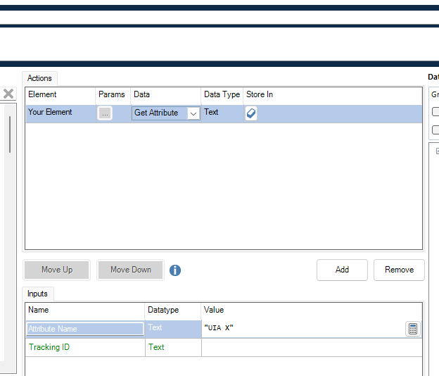

The element screenshots from your application modeler have some X,Y coordinates among the attributes(UIA X, UIA Y, Web X, Web Y, etc.). Are these the coordinates that you need to double click at? Did you already try reading the coordinate attributes using read stage as below?
Also if your are using the latest version of Utility - General from DX, there is a action to perform Mouse Click at desired coordinates. You can call a sleep action in between two click stages to mimic double clicks.
