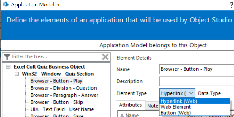

Hi Ewa,
Have you also tried changing the element type in the upper dropdown section and see if any result you were able to get while using the Global send keys or Write stage with that?
WonderBotz India Pvt. Ltd.
Hi Devneet
I tried to change the type element, that didn't help either.
