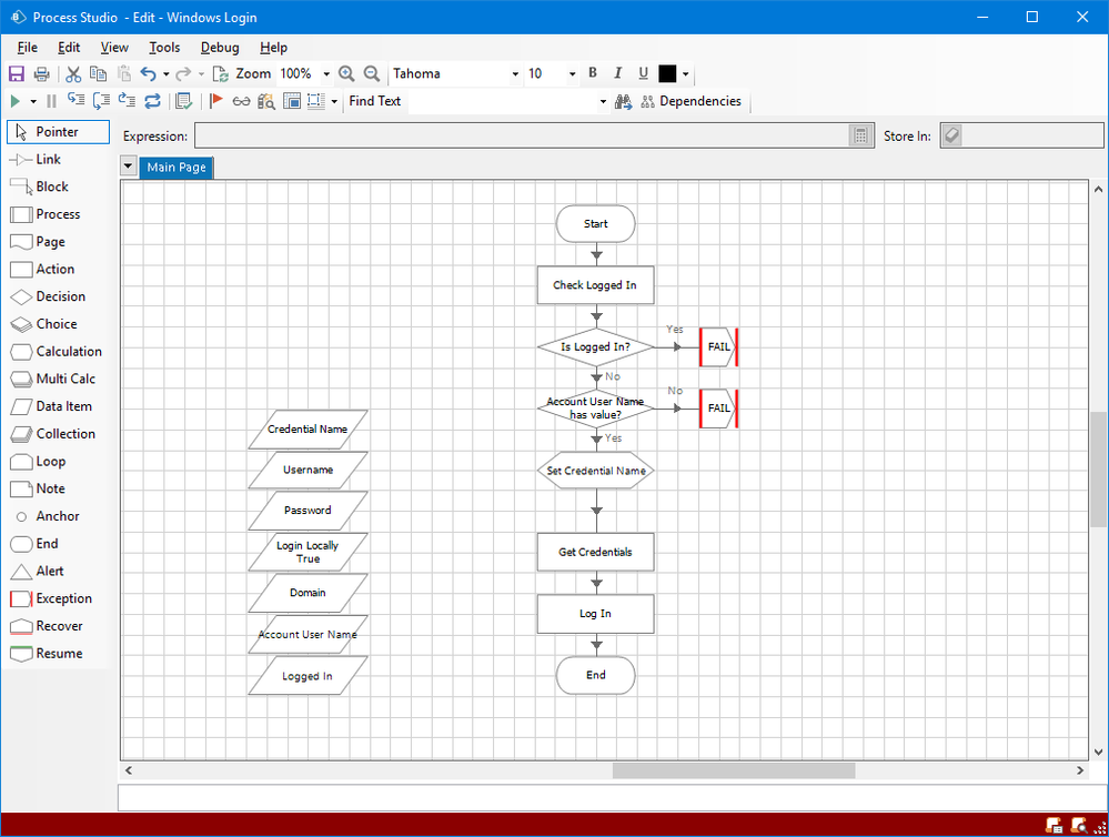

Hi HongJoo,
We use multiple AD accounts to run our bots because each has security unique to the process it runs, so yes, it is possible. We created a copy of the BP canned Login process and modified it to a new one that we called "Windows Login". We changed the startup parameter from "send secure attention sequence" to be a text entry of "Account User Name" and we enter the AD credential name there as a startup parameter.  We further modified the "Send SAS" decision to instead check that the User Name field has data using this simple calculation:
Len(Trim([Account User Name])) > 0
and then subsequently calculate the credential name based on that value
"Windows Login: "&Trim(Lower([Account User Name]))            - store this in the Credential Name data item
We store the AD credentials in BP credential manager so there is no need to input them into the process, and we have these credentials set to not expire so we don't need password reset logic.
Please let me know if this information is insufficient for you to modify the process and I'll see if there's any additional detail I can provide.
Good luck!
Diane Sanzone
