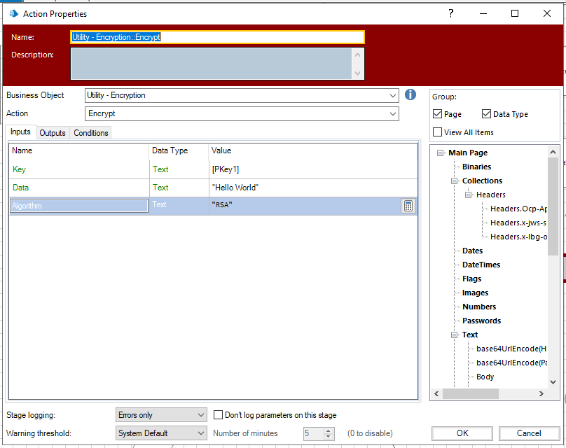

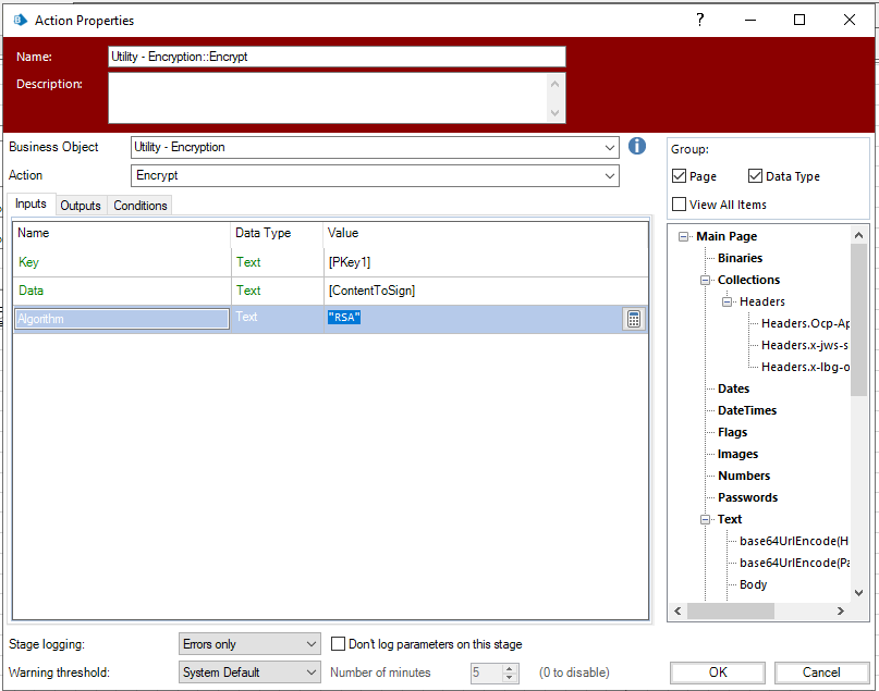

I am having an issue with the Utility Encryption VBO, and was wondering if anyone has any ideas or suggestions?
I have the inputs to the VBO set up as per the below:-
I am receiving the below error when I try to encrypt my text string.
I believe that this is to do with the length of the text string I am trying to encrypt (approx. 300 characters) as if I enter the below, this works fine:-
