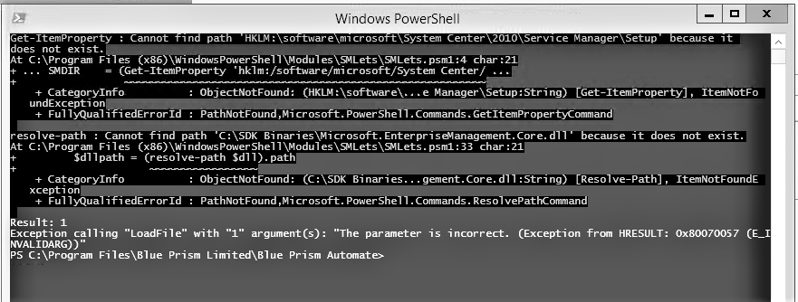

I'm having an issue though... If I run a script manually it works. I run it via this VBO and it gives me an error.
The error is it cannot see a set of registry keys, if I check manually it works. Does PowerShell need to be run with elevated permissions?

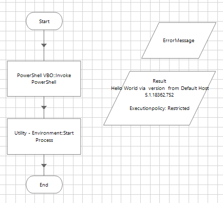

Addition:
Interesting is after I set the the execution policy of the scopes Process, CurrentUser and LocalMachine to Restricted the BP VBO works, but the process not.
It seems that the PowerShell Automation object works independently from the execution policies of the scopes. So this would no longer be a possible reason.

16-03-21 03:57 PM
So, my execution policies are the same as yours. That doesn't seem to be the issue.
I have a colleague at work trying to help me with this. We've not 'cracked' it yet.
I was hoping to use the Powershell module Smlets ( https://github.com/SMLets/SMLets ) in order to log jobs (create a ticket / incident) in Service Manager on behalf of the virtual worker. For example if an automation failed I wanted it to log an incident in Microsoft System Center Service Manager rather than sending an email.
I've managed to create an incident using a powershell script if I run it manually. If I run it via the virtual worker using your VBO it errors. Es ist sehr komisch!!
I'm pretty new to powershell, and I only started working with Blue Prism in July. This VBO you've built though looks great I think it will be very useful to run PS scripts in the future too.
