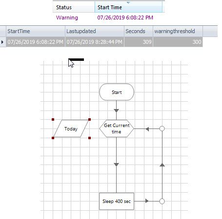

Hi David I recently started working on BOT Wrangler, I was stuck at Warning Query. This helps Thanks for the Info
Rajesh kumar Muthineni
RPA Developer
Highmark Health
America/Chicago
Tried running the attached process with 400 sec sleep, after 300 secs which is more than Thresholdwarning (300) Status changed to Warning.
datediff(ss, max(Session.lastupdated), CURRENT_TIMESTAMP) > Max Sleep or Wait in any Process should give the Accurate warning Processes
