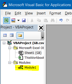

Hi Harshita,
As I can see from your screenshot, it seems there is a module present in the Visual basic section of excel which is with errors.
Try to identify if that module is of any use, if not then delete the VB module so that you won't get that pop again.
