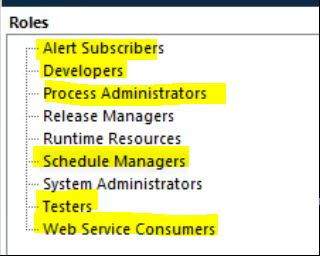

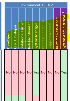

We have noticed that the LAM templates provided in the Blue Prism Portal in the documentation area feature quite different roles than are preconfigured in the Blue Prism software itself. This doesn't make any sense at all. When creating a LAM for an organization and planning it with the template, you will afterwards have to adjust all the technical roles in Blue Prism itself so they fit the LAM template. It is not just that the access rights of the roles differ between the template and the software - there are completely different roles! This means a lot of extra work and just doesn't make sense. Please consider aligning the template with the reality in the software in the future.
37222.pngTemplate
37223.pngReality in the software

Any news about this? Additionally, if we are created new role (ex. Process Controller) and we assign permissions for screens Studio, Control, Analytics, Releases and System then access is not working. That all screens is unavailable. Maybe is necessary other actions from my site.Are you ready to help?
