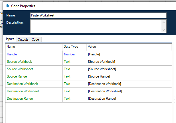

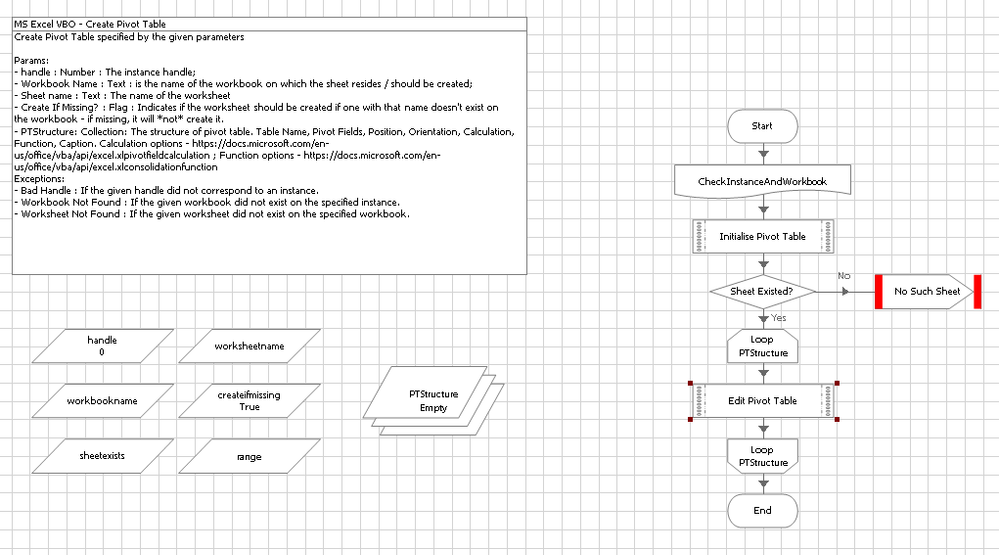

BUT! Since I wanted to create general Action for creating Pivot Table, here is my solution (big thanks goes to sahil_raina_91 on rpaforum).
1. Duplicate Action "Activate Worksheet" and change name (my name is "Create Pivot Table")
2. Change code stage. Add these lines and new input "range" (see img1 and img2):
3. Create Collection "PTStructure" with given fields (see img3)
4. Loop through the Collection and create code stage with these lines:
This is so far the best I can do. I believe there are few things that can be implemented better, but ... whatever.
Code:
rng = range
Dim PCache as object = wb.PivotCaches.Create(SourceType:=1, SourceData:= rng).CreatePivotTable _
(TableDestination:=ws.Range("B2"), TableName:="PivotTable1")
Code:
Dim wb as Object = GetWorkbook(handle,workbookname)
Dim ws as Object = GetWorksheet(handle,workbookname,worksheetname)
If Len(ToString(orientation))=0 Then Throw New Exception("Orientation is mandatory parameter")
If Len(ToString(position))=0 Then Throw New Exception("Position is mandatory parameter")
With ws.PivotTables(tablename).PivotFields(pivotfield)
.Orientation = orientation
.Position = position
If fnctn<>0 Then .Function = fnctn
If calculation<>0 Then .Calculation = calculation
If caption<>"" Then .Caption = caption
End With
Hope this was helpfull.
