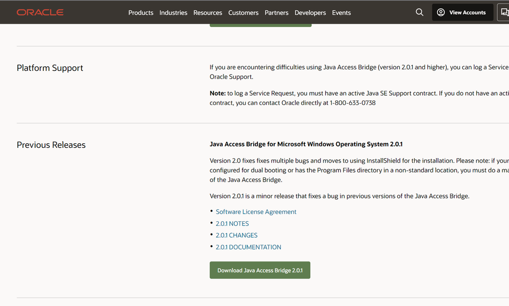

NOTE: I am downloading 32 bit since Blue Prism expects a 32 dll driver for JAB.2) Now, install the Java Access Bridge (2.0.1) from here: JAB 2.0.1 and then install it on your machine.

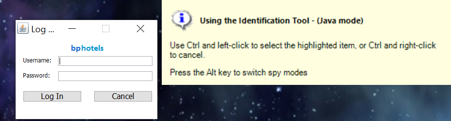

5) Now when you create a new business object, choose the Java Automation option in the Application Modeler inside your Blue Prism, give all the input parameters such as the file path of your application and you should be able to see Java Mode while spying:
6) Spy elements using Java Mode for this application:
