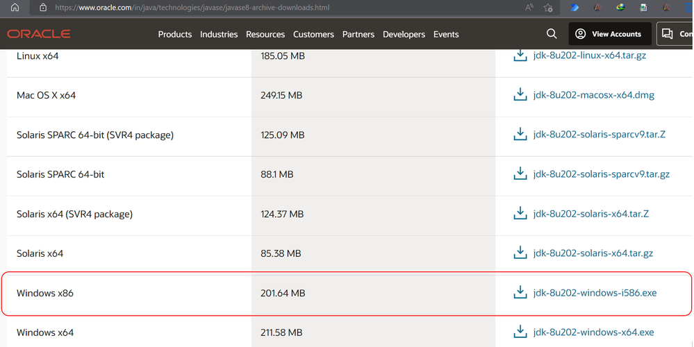

1) Download the Java 8 SDK from Oracle website for 32 bit : JAVA SE 8 and then install it on your machine.
NOTE: You would need to register an Oracle account in order to download it.
NOTE: I am downloading 32 bit since Blue Prism expects a 32 dll driver for JAB.

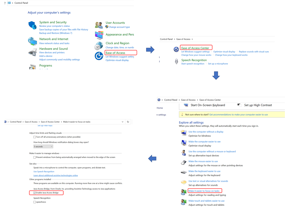

3) Once you have installed both of them, Go to Control Panel -> Ease Of Access Center -> Make It Easer To Focus On Task and check the Enable Java Access Bridge option

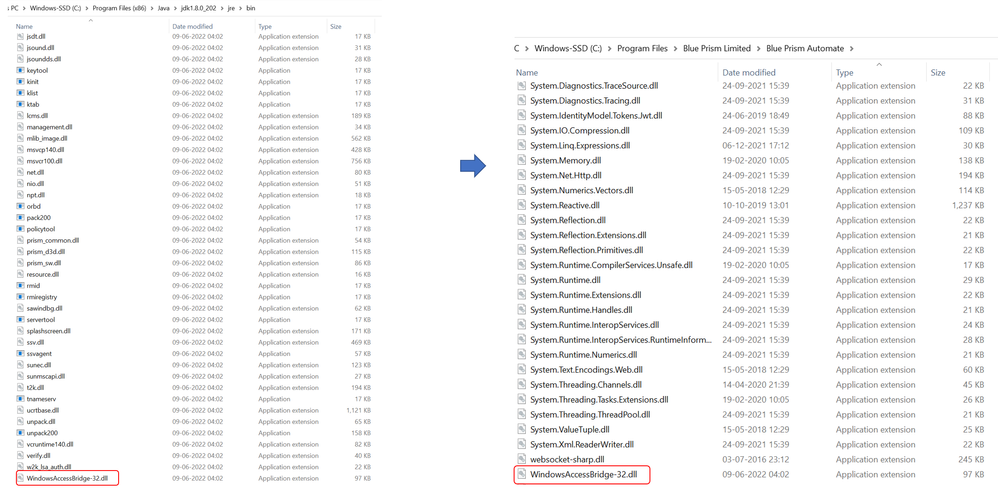

4) Now, copy the WindowsAccessBridge-32.dll file from:

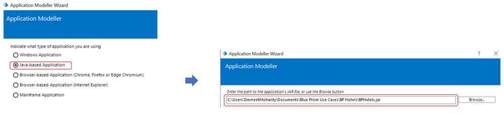

5) Now when you create a new business object, choose the Java Automation option in the Application Modeler inside your Blue Prism, give all the input parameters such as the file path of your application and you should be able to see Java Mode while spying:
C:\Program Files (x86)\Java\jdk1.8.0_202\jre\bin
to your Blue Prism installation folder:5) Now when you create a new business object, choose the Java Automation option in the Application Modeler inside your Blue Prism, give all the input parameters such as the file path of your application and you should be able to see Java Mode while spying:
