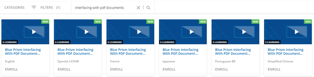

Hi Jay,
Once you are in the Blue Prism University, follow the steps below to locate the information about interfacing with PDFs.
  • Click 'Online Courses'
  • Using the 'Search within results...' box, search for 'interfacing with pdf documents'
  • Select your preferred language.
Hope this helps.
Carl Carter
