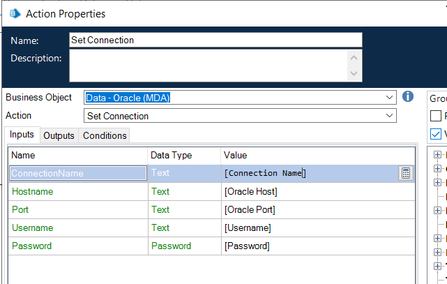

    2. In your process, have you set the connection parameters to connect to your Oracle system?
    Yes we have set the connection parameters and it's working perfectly

    SQL Developer is your client in this case, what is the version of Oracle that you are connecting to?
    Could you show an image of your process that you are using so that I may see its component parts? I need to establish how the execute is being called and what is different about the SQL you are sending. In the meantime, I am configuring an Oracle VM here to try to replicate your problem. Once I am able to replicate it, we can go about finding you a solution.
