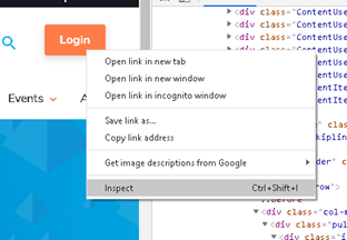

Eg open chrome -> Page you want to spy -> Right click on element -> Inspect
Console opens up with the elements highlighted in elements tab -> Right click on highlighted -> Copy -> Copy Xpath
Do CTRL + F on elements tab – You should see a small textbox open at the bottom
Paste the copied xpath and check if identifies correctly.
The same xpath can be used in application model to identify the element in  BP.
