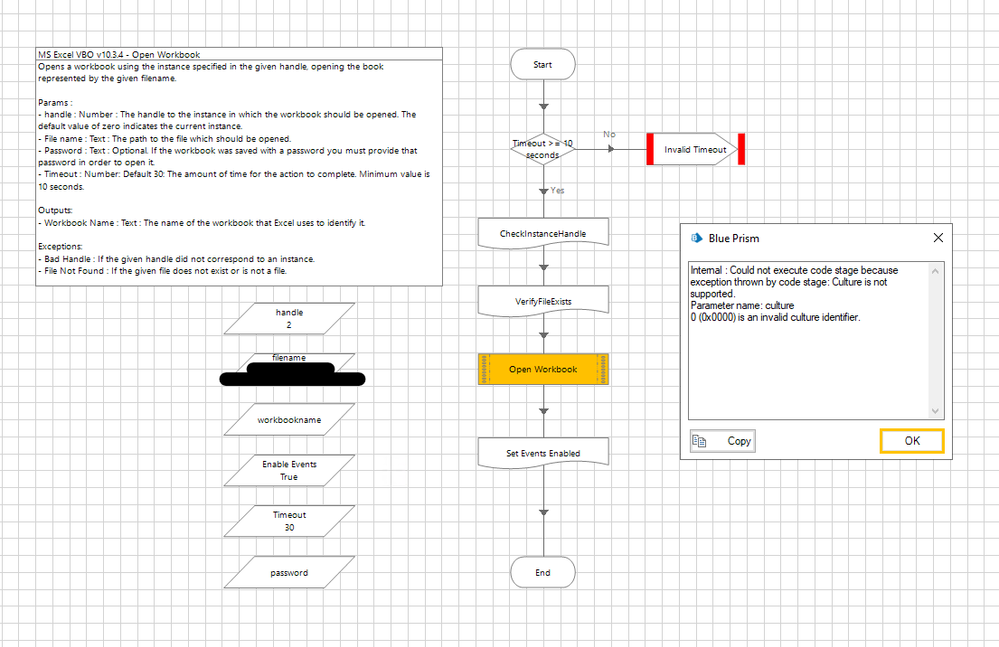

Can anyone please try to help me with this error. I recently added MS Excel VBO from digital exchange. New to the Blueprsim.
During an excel operation I am getting the following error: When I'm trying to open workbook
Internal : Could not execute code stage because exception thrown by code stage: Culture is not supported.
Parameter name: culture
0 (0x0000) is an invalid culture identifier.
Following are the steps which I am doing in BP:
Create instance->open workbook-> show->get worksheet as collection->close instance
Thanks in Advance

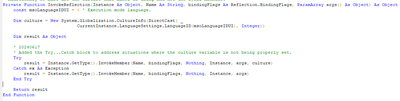

A fix is being worked on now. It seems there's an issue in the Global Code where we try to read the systems culture info, but the .NET doesn't always work as expected.
Should have an update posted to the DX today.
Eric
@bonumeghana @electroisok @SabithaNirmal @rajeshkumarmuthineni @JayantG
Version 10.3.2 of the Excel VBO has been posted to the DX. Should address the issue you're seeing with culture.
Eric

@krlalliram so you've downloaded version 10.3.2. of the Excel VBO from the Digital Exchange, tested with it, and you're getting the same "culture" error?

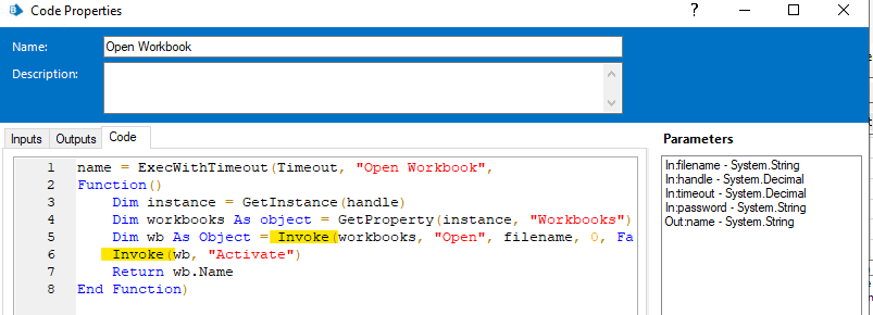

I have downloaded Excel VBO version 10.3.2 and am getting this error. My BP version is quite a bit older though at 7.0.1. However, we don't get this issue with our older version of the Excel VBO so seems to be an issue with the current VBO.
wktan42
@ewilson I have the same error too, and the problem still persist with the following trials:
Kindly advise.
My Blue Prism setup:
  • Blue prism version 7.3.0
  • Excel VBO version 10.3.2 (This issue didn't happen when using version 10.3.0)
