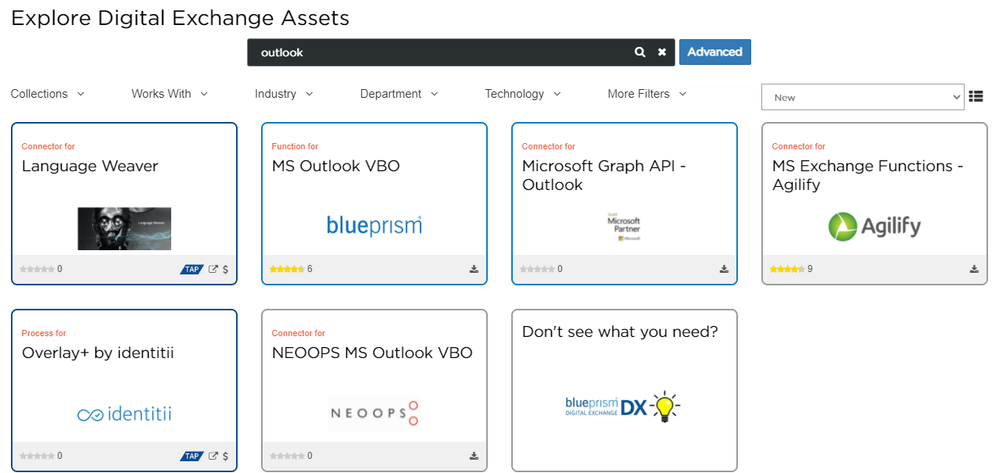

Oh, I'm not aware of the new Shared VBO. Upon search, these are the results. Can you tell me which one are you referring to?
