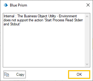

I'm not able to send request correctly, getting more like:
Config
Argiments:
"curl --cert signed-certificate.pem --key private-key.pem --header 'Content-Type:
application/json' --header 'Accept: application/json' -d '{ "entities": [{"identifier":
"[number]", "identifierScheme": "ISIN" }]; "packageId": 8 }' 'https://api-cert.[DOMAIN]api/flex/deliveries/v1'"
Any thoughts?
Now my issue is different, resolution was new Environmental VBO resolved previous.

23-06-23 02:09 PM
Do you have the latest version of the Utility - Environment VBO from the DX? From the error message it seems like you may be running an older version of it.
