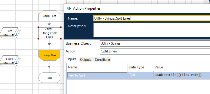

Yeah, it looks like the Read Lines From File action doesn't allow you to just take whatever is in the file. You could count the lines first, but I think below is an easier way. Just use the Utility - Strings object's Split Lines action. And in the input, use LoadTextFile([Files.Path]). And Output to your collection where each line will be in a separate row.

Emerson answered the question already, but I notice you're using the File Management VBO to read the text from the files. There's nothing wrong with that, but I wanted to point out that you can also use the native Blue Prism function LoadTextFile() which you can use in a Calculation stage or directly in the input of some other action stage.
So to put that with Emerson's suggestion, the expression in a Calculation stage might look like this: LoadTextFile([Files.Path])

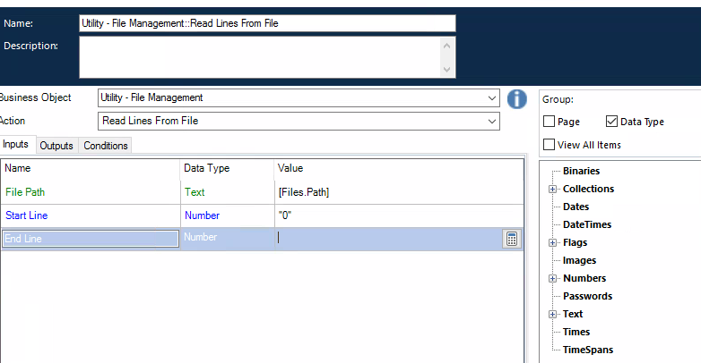

I need one more Solution for Read lines from file action. In the input field I have provided start line as 0.
But I don't know the exact end line number because end line number will be differ in each text file for every loop and also each text file is having more than 1000 lines
So how to give biggest number in End line inputs field?
I have attached the screenshot below Kindly refer & guide me please this also,

in general there are how many lines, you can leave a set value, type end line = 5000
In the start line just put 0 and not "0" because it is a number and not a string, but I believe you need it, you may be using read all text from files that it should take all the lines
