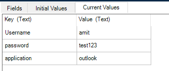

I have tried but still not getting the desired result -
Let me explain My scenario again-
Getting input from Web services for different application - (A,B& C) with different attribute in Json format.
1-  Converted input json in to collection (Jason to collection)
 [ Json
{"Key":"Username","Value":"Amit"},
{"Key":"password","Value":"test123"},
{"Key":"Application","Value":"Outlook"},
Collection

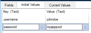

2- Now i need to store above collection in another collection in below format
 3- Use above attribute in outlook application for create user in outlook application.
- I don't know what type of application's input will come if i will get input for Outlook then outlook process will run else run for other application .

Amit,
I am a bit confused now.
1. Do you need help with the collection transformation which you described? Do you know how to use calculation stages to read from collection and write to another collection? Do you know how to create a user in outlook application with Blue Prism? If yes, then you just don't know how to transform the collection?
2. In your last sentence you wrote about "I don't know what type of application's input will come.......else run for other application." Are you saying that you don't know upfront what applications can be requested but you want Blue Prism to be ready for that? If that is the case than you can hardly do it with Blue Prism or any other software if you don't know what is coming on the input side. Or you can prepare a set of applications and if the input data contain the application from your prepared set you do what you are asked to do if the application is outside of the predefined set you trigger an exception.

Hi, Amit,
see the attached file which does what you need. I believe that the trick is the action called Set Collection Field.

Sorry, there was one mistake so resending the right one.
