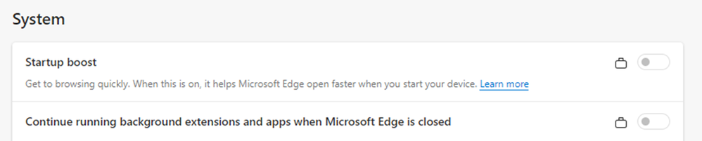

As others recommend, it's always good to go with extension for edge browser related automation. But you can use IE mode combination in case your application running as IE in the background.
For IE mode you will not require any extension generally. Whatever spying modes which is available for IE browser the same will be enabled while using this concept.
1)If you want to go with this concept, you should have either blueprism version 6.10.1 or 7.1. Because these version has more reliability for IE mode.
2)For IE mode, as part of application modeler you need to select internet explorer and then add the browser path as edge.
3) Also below are the few edge settings you need to disable it.
