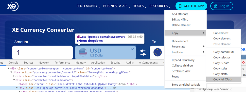

Hi There,
I am new to Blue prism and i self practice BP, i need your help.
I am trying do create a VBO for currency converter portal "xe.com".
I am unable to identify "from currency" and "to currency" web elements but I am able to identify first element i.e "Amount" web element.
I am trying it from couple of days but no luck plz help me.
i appreciate your support.

You can try inspecting the elements' Xpath and using that as the "Path" attribute value. I took a look at the "From" field and found that it is :
/html/body/div/div[2]/div[2]/main/div/div[1]/div/div[1]/div/div/div/form/div[2]/div
But try to get the xpath on your browser as it may be different.
