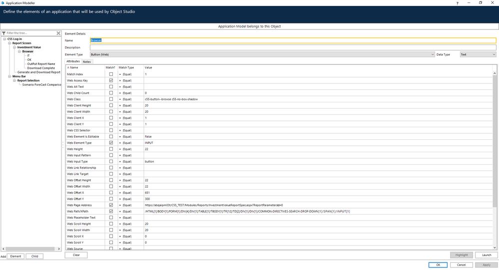

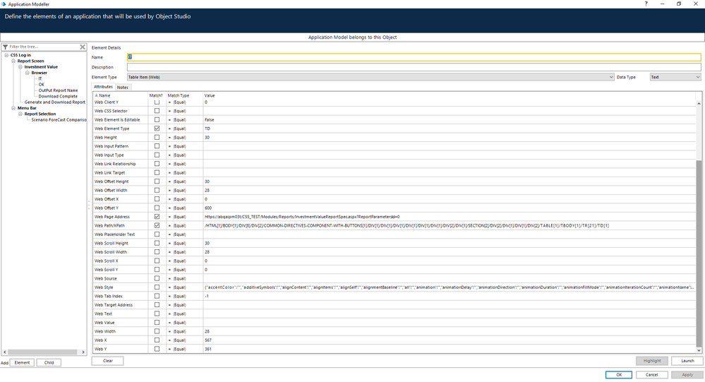

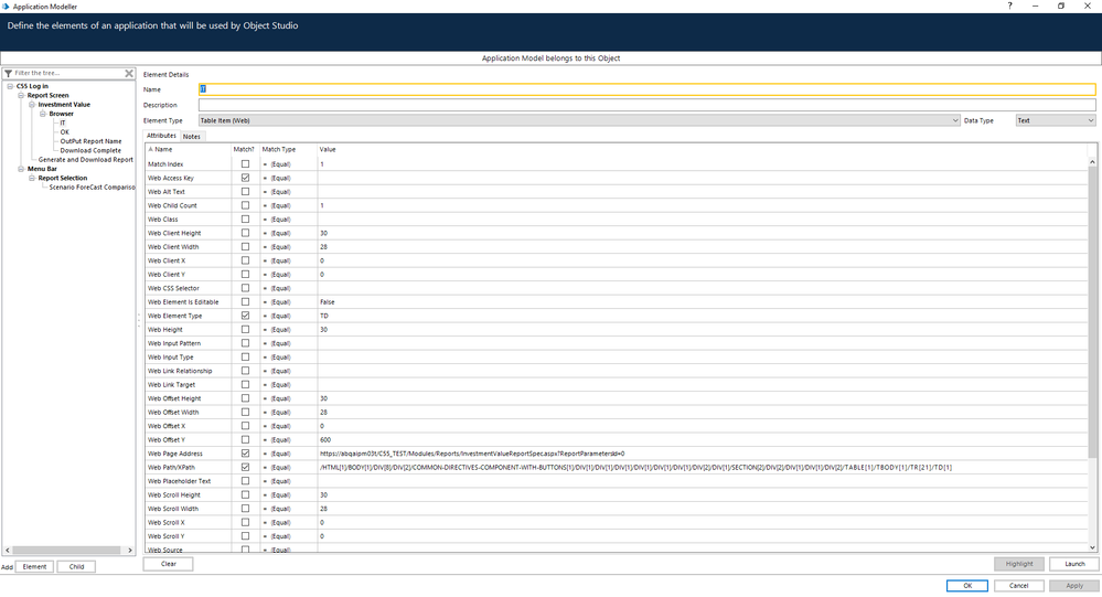

Hello @PatrickPerea,
Are you launching a new browser instance each time you run the process or are you reusing the same instance? Can you post any screenshots of the application model, specifically the make up of the URL pattern (make sure to redact any private information)?
03-01-23 01:45 PM
Hello Eric,
Its a test system so all the information in it is fake so I don't have to redact anything. To answer your question yes it loads a browser (creates its own instance) each time. The only areas that it errors out in is in the browser section and its random. I will also screenshot the IT on the modeler to see if there is anything there.

Hi @PatrickPerea
I would think the issue could be the web path/xpath is changing for each new instance you are creating when the browser runs. Try copying the web path into a notepad and then run the process, when it fails respy the element and then compare the web path to the original and see if any of the div tags/spans are different. If so then this will be the issue and you will have to either make the path dynamic where you can path the path in which is assuming you will be able to know what the new div tags or span id's will be, or, you will need to spy the element using a different spy method.

06-01-23 07:50 PM
I did not even snap at that, thank you so much for your help. I changed the element from hyperlink to button and went by wildcard the name of the selection and so far ran it 30 times and no error.
