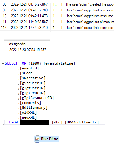

Can we see the failed logins in the database when logging into Blue Prisim?

We can see the log-in detail in the Database, and audit report if any ERRORs it'll capture in the event Log as well
Wrong PSSWRD we can't see after login based on ERROR it'll capture in Event Log

I agree with @Prasanth_IRPA_Dev but that table does not show any data for failed login trials.
I guess what @EsraColak is trying to get is the failed login data for e.g. login with wrong pwd etc. which I do not believe is stored in any DB as far as I know.

Yes you're right 🙂 => Wrong PSSWRD It won't capture, after login based on ERROR it'll capture in the Event Log

I tried entering password wrong twice and it did not get captured in event log as well.
am i missing something?

Yes Neeraj it won't capture, Wrong PSSWRD won't capture. After login based on ERROR, it'll capture in the Event Log
