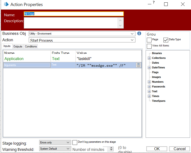

​I had faced the same issue with previous version, We had added one action to kill msedge.exe before launching the Edge in the process.
Select business object - Utility - Environment & Kill process as action to kill the process.
I know this is not end solution. However, it's just work around for the issue​.

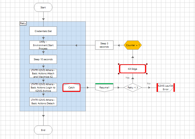

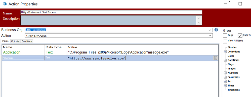

Hi @John Schreier  is it launch action that is failing or the attach action ? and if its launch action are you killing the browser before each retry ? - I would usually leverage Utility Environment - Start process action to launch, wait 5 seconds and attach it via Business Object
If Launch fails from this block I would kill edge by Taskkill and retry it:

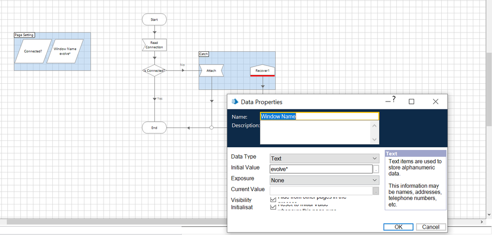

If its attach which is failing - Keep the windows title as wildcard * : something like this and check if its highlighting the outer window- if the window titles are changing and if at least some part of window title is common in each window better to use that as wildcard  :
