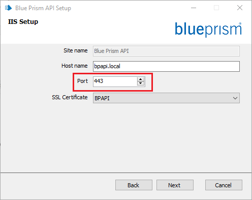

Recently while configuring web based control room we found that only one database can be configured per API.
We have multiple database connection in our single environment, how we can install the Blueprism API for multiple database.
  • We have 5 databases and to see all the process in web based control room, do we need to configure 5 different IIS Blueprism API server with different port?
This will led to increase in number of web servers? or am I lacking something. Do we have solution for above query?

I believe you are partially correct. When the API is configured it is tied to a specific database instance, but I don't believe that means you need to deploy multiple web servers per se. In other words, a single web server could handle multiple API instances on different ports. So, if you deploy the initial API instance on port 443 you could try deploying another instance on say port 8443.
Does that make sense?
Cheers,​
Hi @ewilson
I recently thought of this pos​sibility but then this thing comes, like on one server we can use this setup only one time while installation. Suppose if you have to install it as other IIS site and other ports you need to replace it the existing ones (That IIS Port or Site comes only one time in first time installation). Because if you choose the repair option you won't find above options, the only way to change the site or port is to uninstall and install the Blue prism API again. Correct me, if I am wrong 🙂
